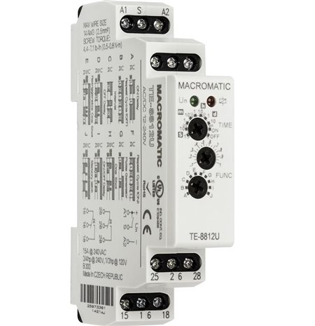

How do you adjust the timing range on the Macromatic TE-8812U time delay relay?
Macromatic TE-8812U Time Delay Relay, 12-240V, DPDT
Open Nov 14, 2025 - 09:15 AM
Relays
Nov 14, 2025 - 09:23 AM
Timing ranges on the Macromatic TE-8812U time delay relay are chosen via the adjustable dials on the front. The top dial selects the timing range, while the middle dial sets the time within the range. The lower dial selects the timing function.
