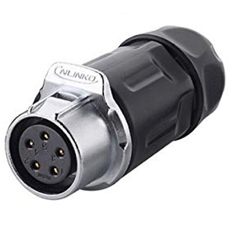

The Cnlinko LP-20-J05PP-01-001 connector fits with the LP-20-C05PE-01-022 plug. The LP-20-C05SX-03-101A is a next generation design and will not work with the older designs. The LP-20-C05SX-03-101A fits with the LP-20-J05PE-01-002A which has a plastic housing, or LP-20-J05PE-03-001A which has a metal housing.
