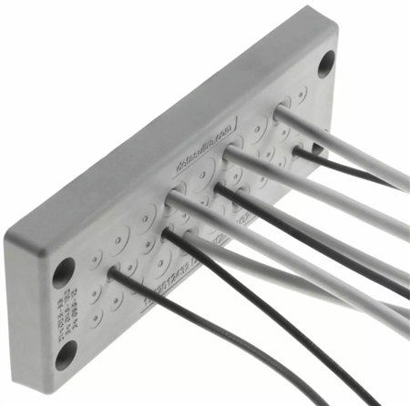

While white cable entry plates are not available, it is recommended that you use the modular cable entry frames with the slide in inserts. Up to 5 frames can be connected together. Each frame can hold up to 10 inserts. Inserts are available with up to 4 cable entries each. There are split inserts made for pre-terminated cables, or if your CAT6 cables are not yet terminated, there are push-in style inserts for non-terminated cables. The non-terminated inserts have one cable entry each. Inserts have a fit a range of cable sizes and are available in gray or black
If waterproofing is not a requirement, there are also the cable frames with brushes that can fit a wide range of cables
