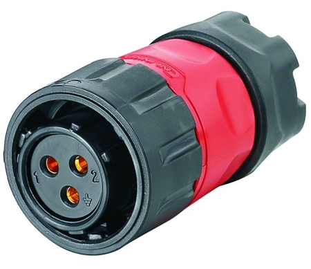

I am doing a bulkhead receptacle, YM-20-J03PE-02-001 and YM-20-C03SX-02-401, is this the correct mating pair? Are we able to key these differently since they will be located on the same panel.

The Cnlinko YM-20-J03PE-02-001 and YM-20-C03SX-02-401 are the correct mating pair. While they cannot be keyed differently, as all YM-20 series connectors are made with the same color and designs, you may be able to differentiate them by adding your own color tags to the housings.
