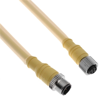

Since the Mencom MDC-4MFP-0.3M-A50 M12 armored cable is a double ended cordset, the pinout is one to one, meaning Pin #1 on the male connector corresponds to Pin #1 on the female connector and so on. The color code is:
1- Brown
2- White
3- Blue
4- Black
1- Brown
2- White
3- Blue
4- Black
