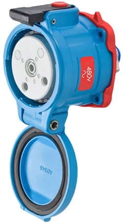

The Meltric DS and DSN series switch rated power connectors are similar in appearance and function, however there are a few differences. The main difference is the DS series connectors have a different size housing that is slightly larger than the DSN series. The DS series goes up to 200A, while the DSN series goes to 150A. Both offer Type 4X/IP69/IP69K ratings, while the DS series also has Type 3R rated connectors. Both offer poly and metal housings, however the DSN series only has metal housings for the 100A and 150A connectors.
