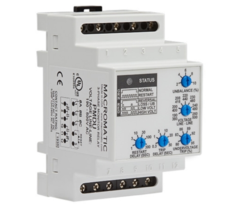

Yes, the Macromatic PMDU phase monitor relay can be panel mounted. Simply pull out the two DIN-Rail clips on the back side of the relay until the mounting hole in each one is visible. They will snap into place once fully extended. It can then be installed on a panel using a #8 screw in each clip.
