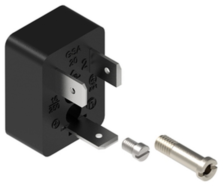

The Hirschmann GSA 20 is not a Form A to Form B adapter. It is a male Form B DIN 43650 solenoid valve plug. If you are looking for a Form A female to Form B Male adapter, that is not currently available. This is mainly because Form B DIN 43650 connectors are mostly used on narrow hydraulic solenoid valve banks and the width of a Form A would most likely be too big for a valve bank.
